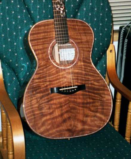

Flamed black walnut with redwood...walnut and redwood are a match made in luthiery heaven. Here's a top:

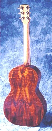

Here's a back:
And I've made a few!

Colby...the flamed stuff is cantankerous as Howard has eluded to. The photo I posted is a guitar owned by an "anal" (and I mean this in a positive vein)player. It's always in it's case when not in use, proerly humidified, not hung on a wall, not taken to Open Bar...er, Mike nights and so on. It's 6 years old with no problems.
Having said that, I have retopped 2 others that DID NOT receive that kind of treatment and suffered the consequences. If it's going to be your guitar, then go ahead. If it's going out in the world, I'd highly recommend a change to a straight grained top (and I have plenty if you need one).
OR...get hold of Tim McKnight and talk to him about the hex-celled Nomex he makes double top guitars with (money wood/Nomex/lower tonewood tops) and you can use the flamed stuff all day. I think PeterM, on here, has also done this as I have sold him a couple sets just like the photo.
